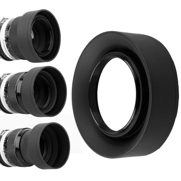

From a photographer point of view, if your camera is next to fixed glass you could try cutting all the reflective light around the glass, such as this item
i am sure @Kami_Mark could give the outer dimensions of your camera if a outdoor camera is not viable. Not a perfect solution but if you are in a pinch could be better than you are currently experiencing.
